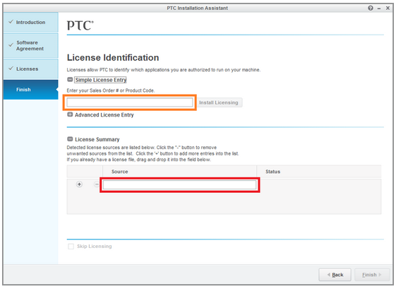

Hello, I just signed in for the student program to get a licence and use Creo 3.0 and I received an email from PTC but the problem is that I dont find the licence, and I dont know what it looks like and wher to find it on the email I received. Can anybody help me please ?
Thanks in advance
    January 19, 2017
    The license file is an attachment to the email from PTC.
    Save it to your computer and then when the setup program asks for the license file, grab that file.
    If there is no attachment, then you don't have the right email yet.
    mbaud1-VisitorAuthor
    January 19, 2017
    Yes I have that email, there is an attachement with a file full of code lines and I did save it on my computer but what do i do next ?
    sorry if its a stupid question but i'm just starting
    January 19, 2017
    go to https://support.ptc.com/appserver/auth/it/esd/academicFree.jsp (you have to login), download Creo 3.0 zip file (I hope that your Windows are 64-bit), unzip it and run setup.exe.
    During installation drag and drop license file into red field.
