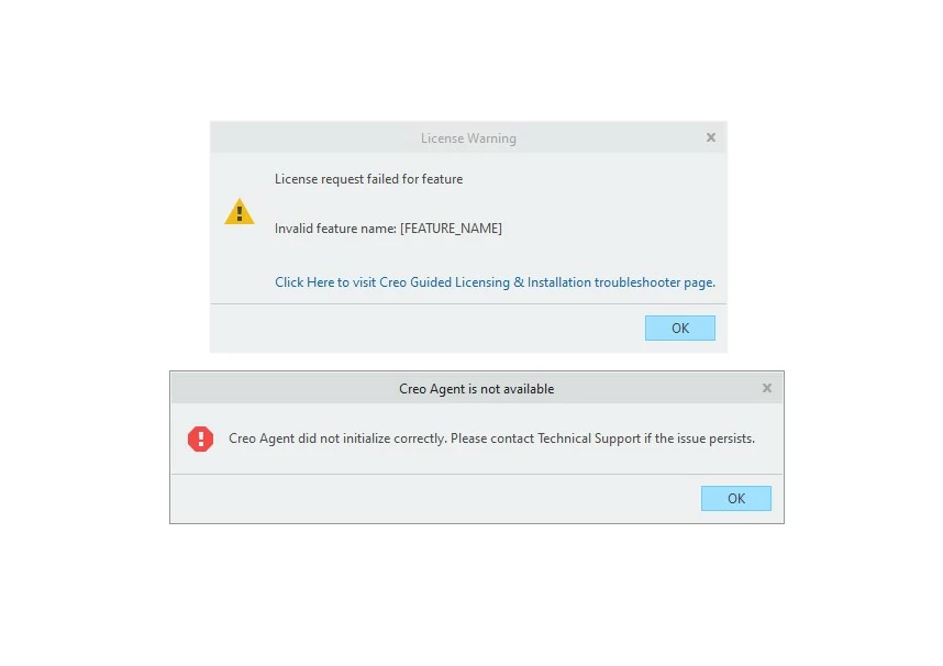

the message tells you that you did not configure Creo to use Student license.

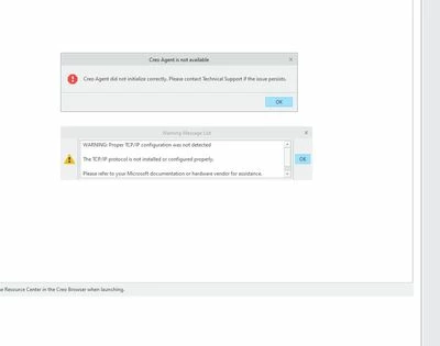

Hi
I configure it for a student license but it is not working. and the problem is not solved.
Mar 24, 2023 11:47 AM UTC
@Alessio.Monzavi wrote:
Hi
according to https://www.ptc.com/en/support/article/CS37242 you have to:
  • Configure TCP/IP using the following steps:
  1. Select Windows Start menu
  2. Select Network connections
  3. Right Click on Local Area Connection
  4. Select Properties
  5. Select Internet Protocol (TCP/IP)
  6. Click Install
  7. Restart the system
According to https://www.ptc.com/en/support/creo-admin-troubleshooter/other-symptoms/Creo-Agent-not-initialize-correctly
Starting from Creo Parametric 4.0, Creo Platform Agent is part of Creo Platform Services package.
Repair PTC Creo Platform Services
  1. Find program named PTC Creo "#" Platform Services from Control Panel > Programs and Features
    • Where # is based on installed Creo release, e.g. PTC Creo 6 Platform Services
  2. Right click and select change > Repair to repair Platform Services
Reinstall PTC Creo Platform Services
  2. Right click and select Uninstall to uninstall Platform Services
  3. Run creosvcs_64.exe from the folder "Creo installer":\install\addon\ of Creo Parametric installation medi
  • Note:
    • The automatic installation path is "PTC folder"\Creo\Platform\"version"
      • e.g. D:\Program Files\PTC\Creo\Platform\4\
    • The manual installation path can be any folder
      • e.g. C:\Program Files\PTC\Creo\Agent\
