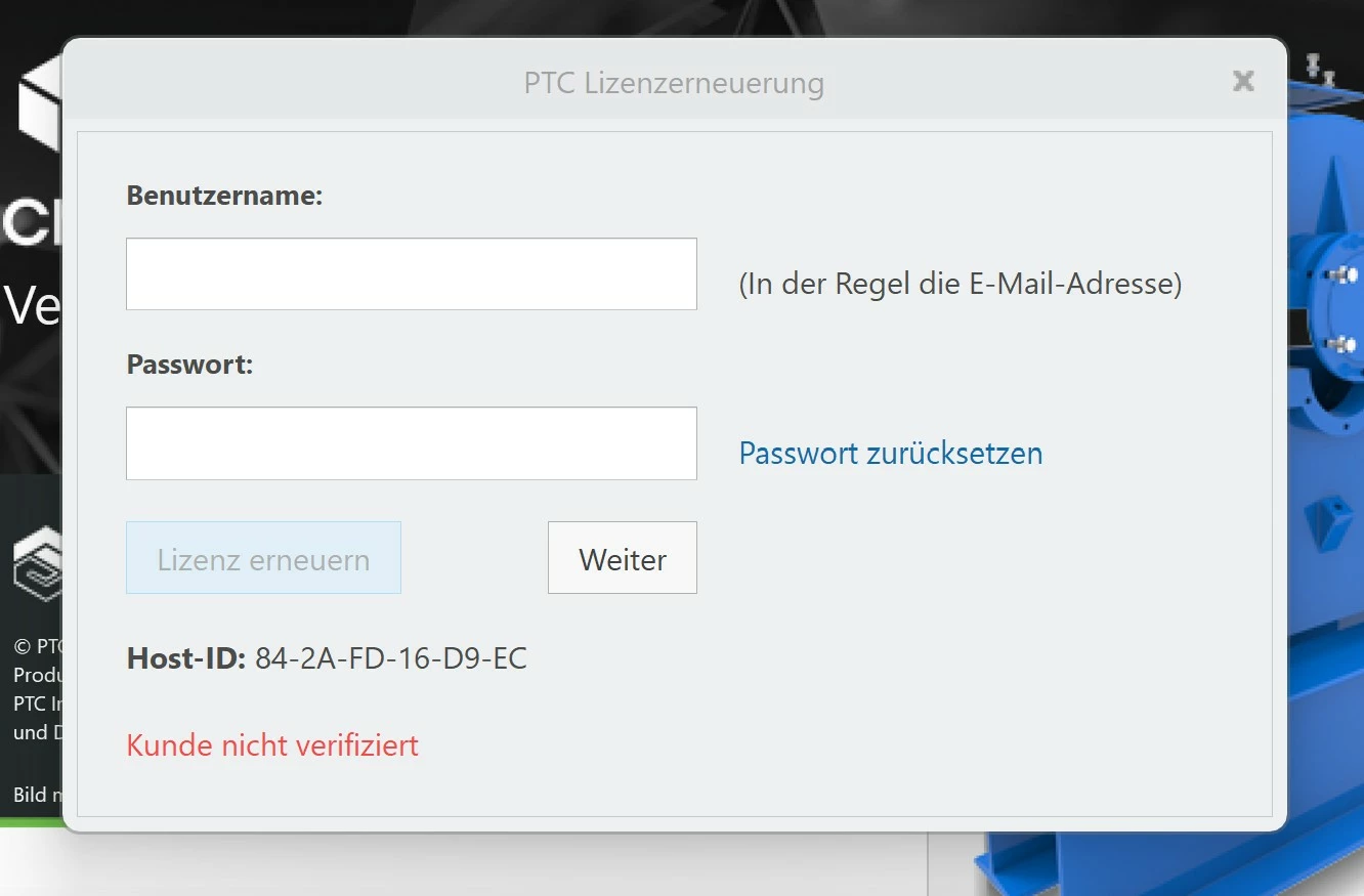

Student licence creo 7.08 expired Renewing of licence failed, because customer is not verified

Dear Team,
what can I do to get the Licence bug fixed?
The old licence expired on 16.04.2025, in the meantime my PC had an update from windows 10 to Windows 11  (64bit each)
I tried to follow the licence renewing process, but the system does not verify me as customer.

Best answer by MartinHanak
you can request license file via email. Please read https://community.ptc.com/t5/PTC-Education-Forum/Creo-Parametric-9-0-Student-Edition-Licence-error/m-p/897846 discussion.
