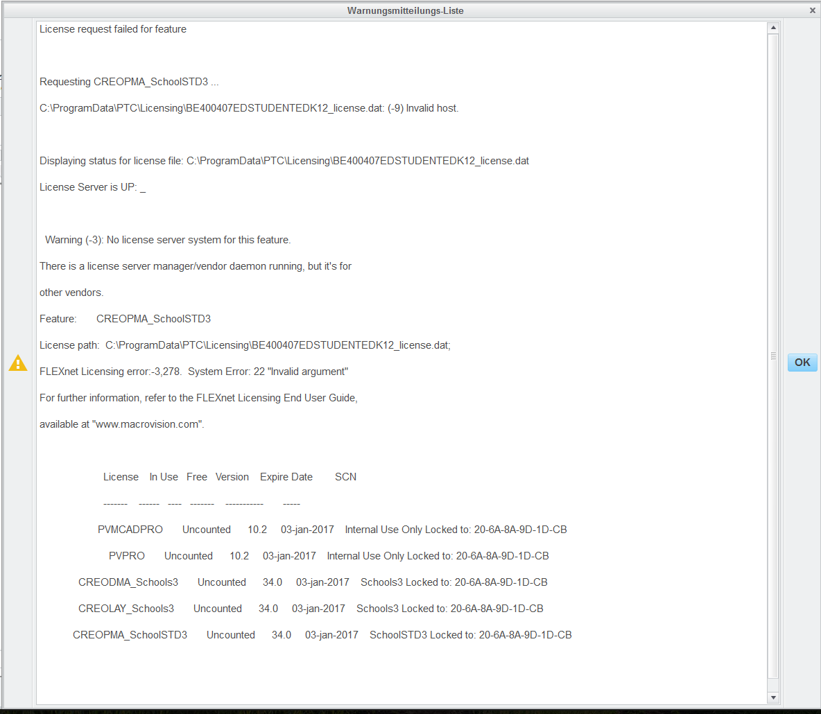

    August 12, 2016
    What means this and what can i do?
    I got a license from school that i can also use the application "welding" at the student version creo 1.0.
    Can i use this license and how i can write it in?
    August 14, 2016
    licenses included in license file are related to HOST-ID 20-6A-8A-9D-1D-CB. I think this HOST-ID is not equal to MAC address of network card installed in your computer.
    If license file does not contain SERVER and DAEMON lines, then it contains locked licenses. In this case you cannot use this license file.
    If license file contains SERVER and DAEMON lines, then it contains floating licenses. You have to connect your computer to LAN where computer with HOST-ID 20-6A-8A-9D-1D-CB is connected. Then you can reconfigure your installation to take the license from this computer using notation 7788@computername.
