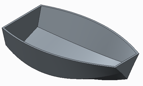

    Not sure if you are aware the profiles in a swept blend must all have the same number of lines/nodes. I use the hull of a small sailing dinghy to illustrate this.  The stern and mid profiles are very similar with five straight lines.  The bow section looks like it only has three lines.  In practice each of the sloping lines is made up of two constrained to be inline.  You can see the chines blend into the join between these two colinear lines.Loft_profiles.png
    And here is the same hull shape shelled out.
