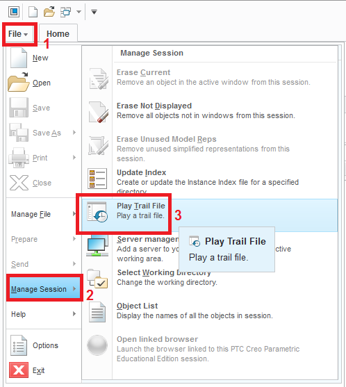

How do I enable so I can play trail files?
    April 25, 2017
    You don't. It is that way to prevent users from using recordings. I don't know why, but that's the case.
    You can record mapkeys and those can be quite long.
    Or you can use tools like AutoIt to drive the interface in programmable ways.
    April 25, 2017
    • select trail file you prepared for replaying
    • OK
