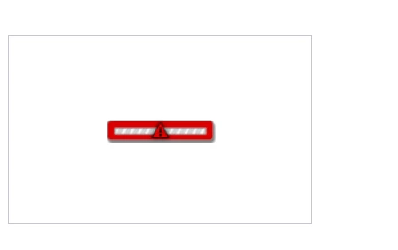

July 21, 2022
Thank for your response @PaiChung
My service returns the list. However, the problem I am now facing is getting the list widget to display the service output.
What I have already tried: Setting the Value and display field  widget properties to: "Name".
Pulled "All data" from my uncategorised service on the mashup.
Yet I still have a red block displayed on the list widget.
What else I am missing?
