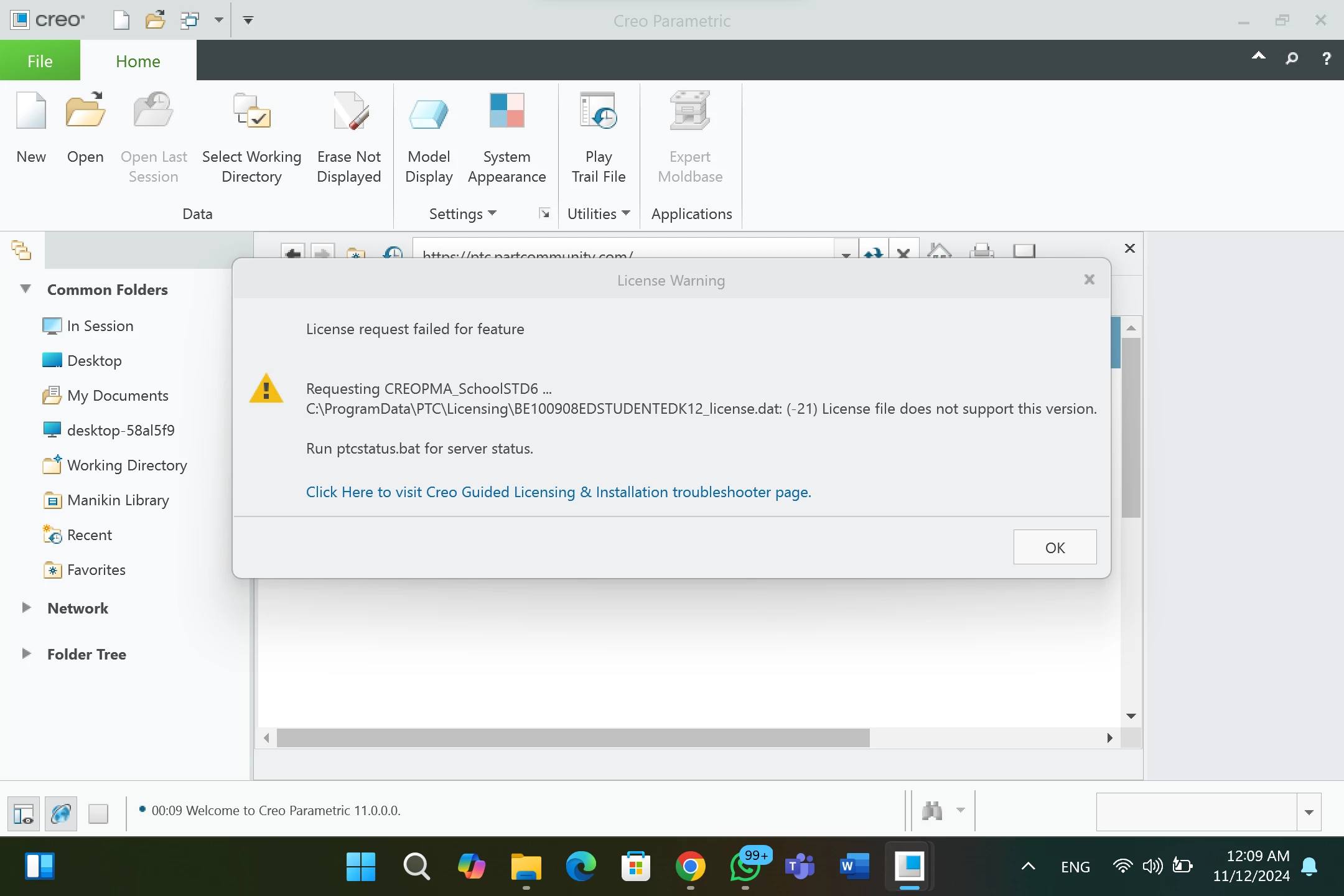

What version of Creo are you trying to use?
November 12, 2024
license file mentioned in the picture belongs to Creo 10.0 -AND- you started Creo 11.0.
Please read https://apps.ptc.com/schools/references/install_creo11_schools_standard.pdf document carefully.
