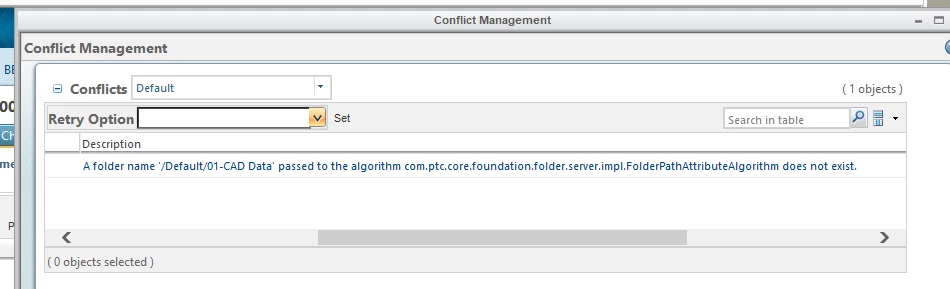

We have been using Windchill 10.2 for a while now along with Creo 2.0. Creo file management has been working fine.
Today we no longer seem to be able to upload parts. When I try I get "Upload failed" and "See the Event Management console for details". When I go to the console it is blank and provides no additional information.
We have one member who just started using Windchill and is using Creo 3.0 (we were going to all upgrade, just didn't do it yet). She tried to upload a part and got the same thing but got the following in the event console:
Transaction aborted when accessing versioned row in table 'first.QueueEntry' in database 'first'. Requested versioned row was not found. Your tempdb is probably out of space. Please refer to BOL on how to configure- tempdb for versioning.
Any thoughts on how to get us back up and running? Everything was working very well up until today...

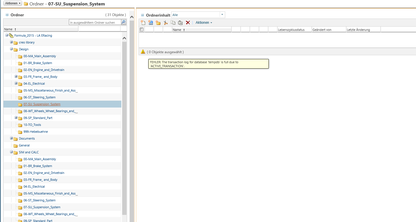

    Our Team has the same problems.
    And we have one folder were all files are gone.
    Nov 28, 2014 6:17 PM UTC
    Our FTC team is having the same issue. The folder where our parts are stored is showing 0 files.

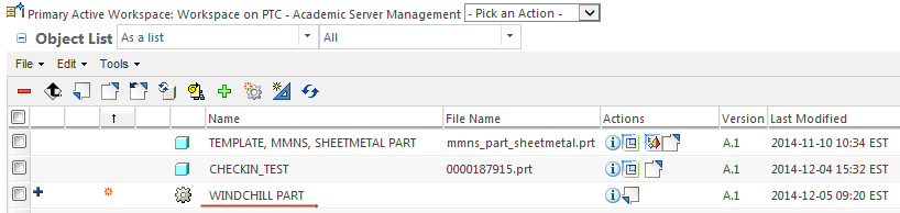

    Can you check the options tab of your check in form and make sure Associate Parts is not selected? There is no need to create Windchill parts as part of the Check In process.
    This option should be off by defualt in your project and your workspace.
    I have also put in a request for the administrative team to take a look at the error message and determine if there is a DB issue. I was able to check in new parts today without any errors. Please let me know if you are still having the same issue.

    The error message is telling me that somewhere along the way or during the check in process you have created or are attempting to create Windchill Parts to associate with your CAD files. Do you see any files in your workspace identified by a gray gear as shown below? These files should not be created and should not be checked into your project. There is no need for them.
    If the problem continues, please send me a PM with the name of your project and some details about the problem files, workspace, etc.
