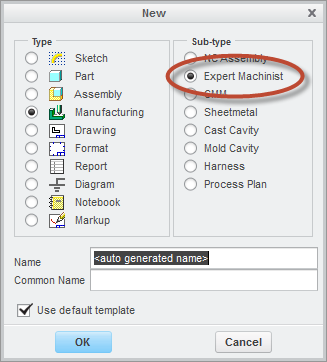

I'm trying to add a NC path to one of my models to allow it to be milled out of a bar by a CNC machine, but every time I go to start a NC manufacturing, or any sort of manufacturing for that matter in the Creo 2 student edition, I don’t get the manufacturing tab or any options. It thinks about it for a second then doesn’t do anything. I get no change from whatever screen I'm in. As a stopgap, I created a NC work piece over the top of the model in assembly, but I can’t get manufacturing to load or open to do anything else.
I feel like I’m missing something, pointers?
    Best answer by
    The Student edition of Creo 2.0 provides access to CAM lite, 2.5 axis milling via Expert Machinist.
    For additional capabilites you would need to purchase an Academic edition.

    Cheers, I'll borrow the University’s copy to finish the model. I figured it would be something like this but couldn’t find the documentation to be sure.
