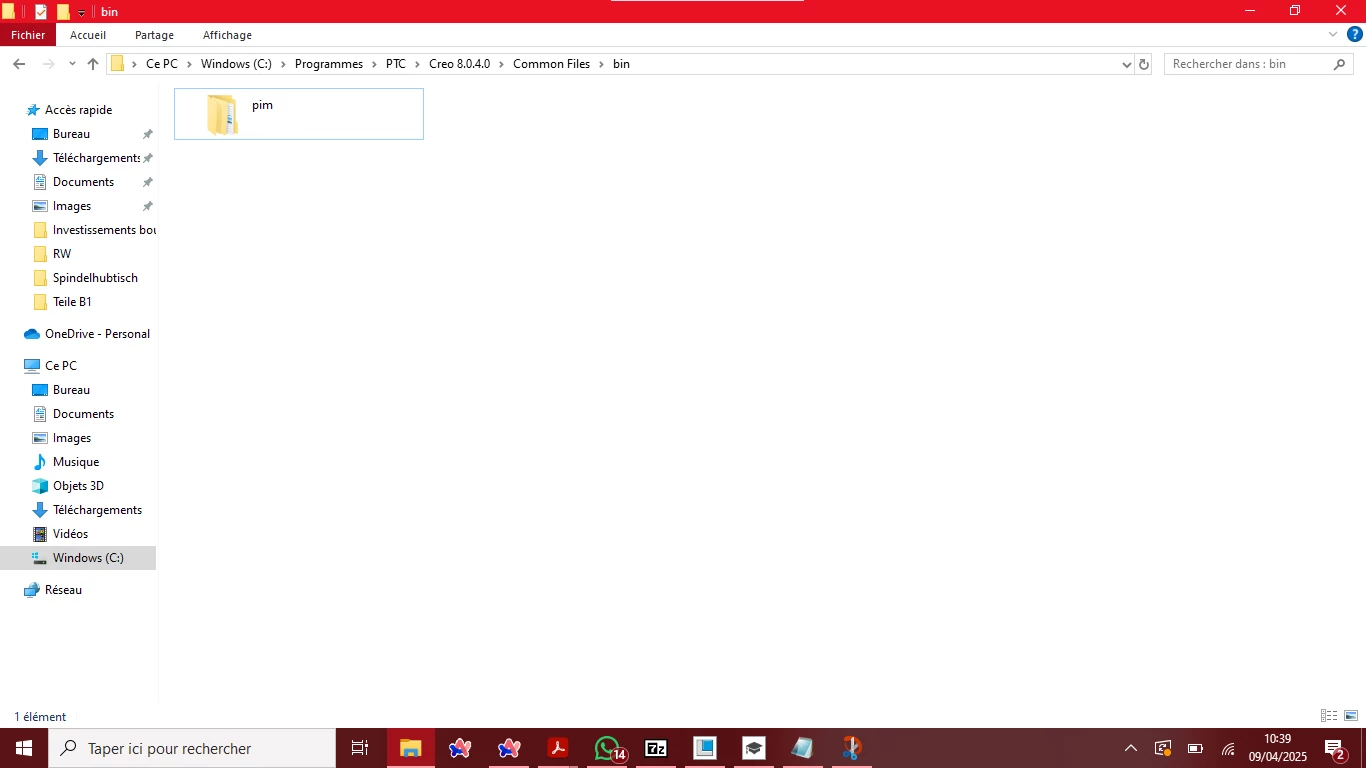

Hi!
I'm spending hours to try to change the language of my PTC Creo, but without success. I already chose to add the language german in the Installation window, and what I read everywhere is to add a specific line in a PSF file, however there is no PSF file on my computer ; the Folder bin, which took a lot of efforts to find, has no file (just another Foldder wtih XML files).
Can I add a psf file? How? Can somebody help me please to change the language from French to German
Best answer by MartinHanak
parametric.psf file is located in MartinHanak_0-1744192953375.png directory
Also you have to enable displaying of filename extensions.
April 9, 2025
