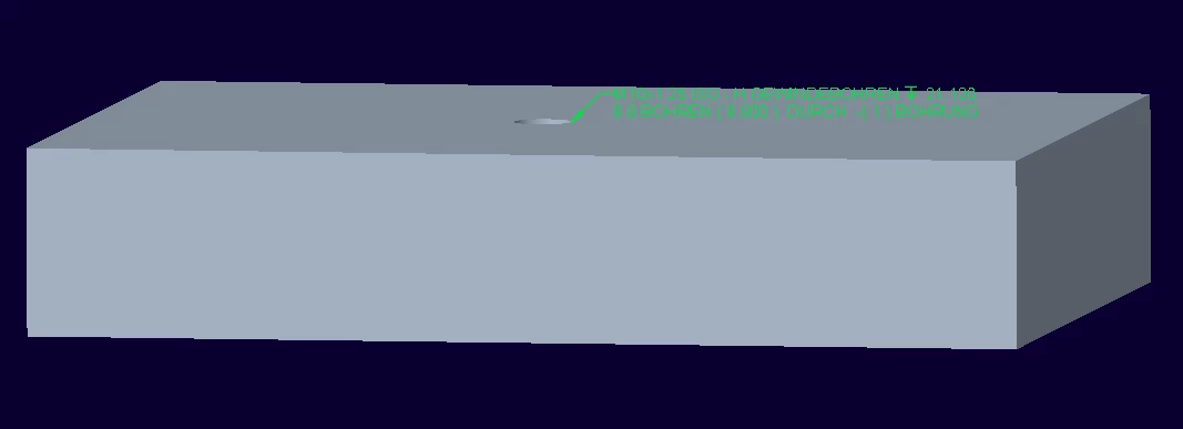

Hello guys,
when creating threaded holes, Creo always adds an annotation to them (see attachment). These are annoying since I never use them and they mess up my screen when working with e. g. GTOL annotations. Is there a config option or a layer tree rule to turn them off or hide them? (I know I can turn off all annotations by toggling the annotation button, but that is not what I want to do as there are some annotations I actually need).

create associative rule in layer.
March 22, 2019

Hello Martin.
super, just what I needed.
Greetings
