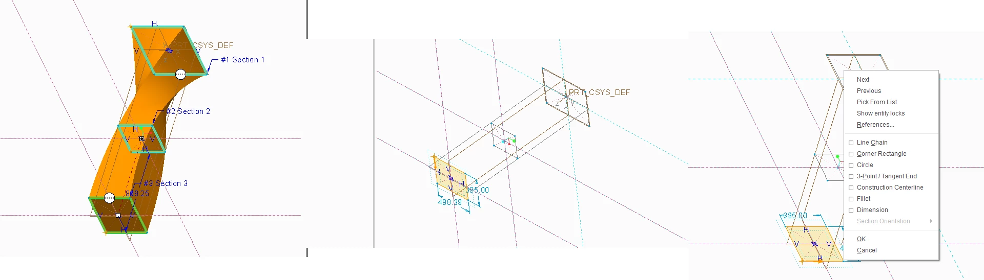

I am trying to remove a twist in the middle of a section. The online PTC program told me to right-click a vertex of the end point of the blend and then select "Start Point" but this option doesn't seem to be there?
I would appreciate some help.

    Hey Ryan,
    Make sure that the point is selected before you right click. You might have deselected it while right clicking.

    HKhoi is it a swept blend you are trying to create??

    Hey Ryan,

    Also make sure the section you want to change the start point on is selected.
