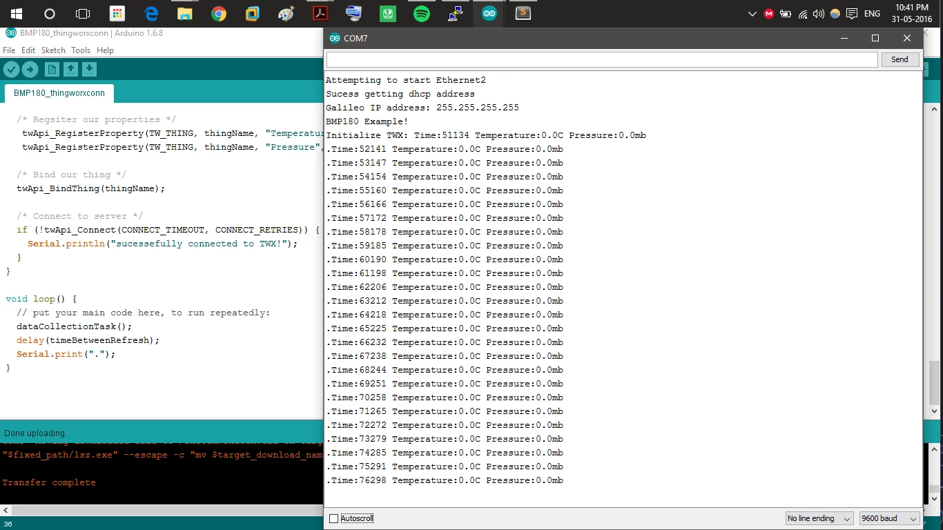

I'm trying to connect my Intel Galileo Gen 2 board to thingworkx. I'm following the tutorial  Weather Application with Intel Galileo | ThingWorx  . In the example, they have used the HTU21D sensor . As it wasn't available where I live, I'm performing the tutorial  using  a BMP180 sensor. I'm using it to sense temperature and pressure.
I have modified the code given for HTU21D , as follow for BMP180:
Note: For security reasons in have modified my API KEY and MAC address.

Every time when I burn the code to my board  the serial monitor waits for a while after printing "Initialize TWX:" and then start printing the temperature and pressure 0 without giving any information regarding the connection! I have attached the screenshot of Serial Monitor and the original as well as modified code . Please let me know where I'm going wrong .

Hi Rishi,
You said that you have no confirmation on the connection. Does that mean that you don't know if your Remote Thing is correctly bound ?
if that is the case you could test If you have the same name in the Identifier section, it should be bind to the Thing automatically. In case it doesn't, you can either browse and choose in the Identifier section on the Remote Thing (preferred way) or just type in the Identifier's name in the same section.
Hope this helps
