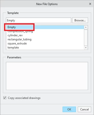

I don't have the student edition but I vaguely remembering seeing posts like this in the past.  I believe the problem has to do with the student edition not being able to open commercial edition files and the commercial edition not being able to open student edition files.  I'm pretty sure the default templates included with the student edition were actually created in the commercial edition and can't even be opened by the student edition.  If this is indeed the case, then you should still be able to create new 'empty' models but you won't be able to create anything from the default start parts/templates.
