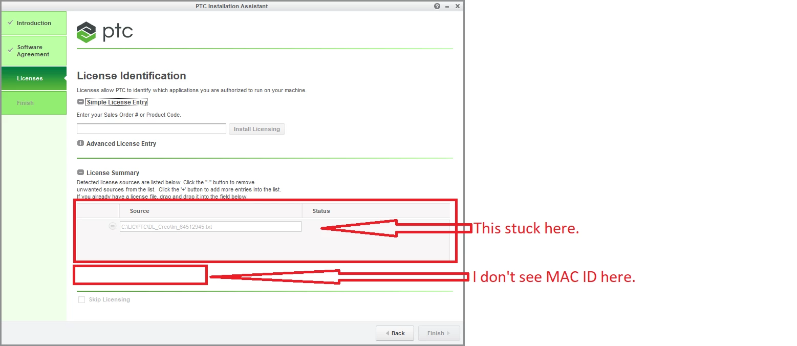

Unable to reinstall Creo after system format.
I have a perpetual license of Creo 3.
I have installed Creo several times in the past. But recently I have formated my laptop with the OS I am using previously, Windows 10. During installation even it is not detecting the network card. I have tried disabling firewall. But still it is same issue mention in this thread.

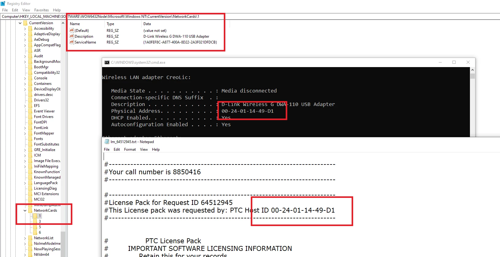

open Command prompt window and run ipconfig /all command. The output of command shows network card. Check whether HOST-ID included in license file is present in the output.

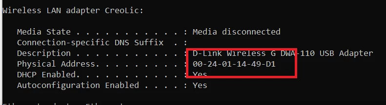

3-Newcomer
August 2, 2023
I did the said checks before installing. Find attached.

The above output is telling you that D-Link Wireless adapter is turned off.
Connect to network using D-Link Wireless adapter. This way you turn it on and Creo will find it.

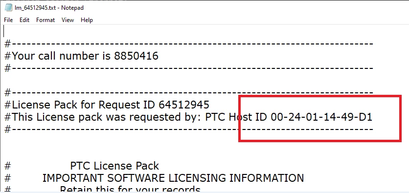

The above picture does not tell me whether your license is locked/floating.
If your license file contains SERVER and DAEMON lines (see below example) then your license is floating. In other case your license is locked.
SERVER __HOSTNAME__ PTC_HOSTID=00-24-01-14-49-D1 7788
DAEMON ptc_d __PTCD_PATH__
