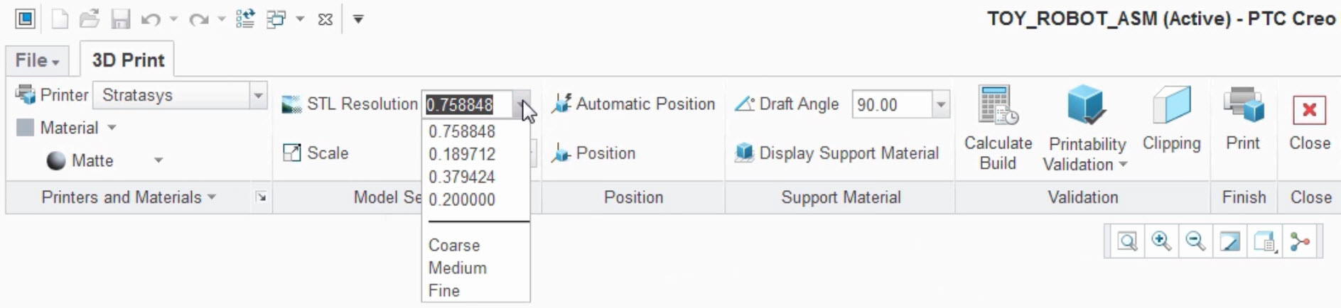

The PTC Education team is busy getting Creo 3.0 M040 ready for download. This new update of Creo 3.0 includes all the new and exciting capabilities to support simplified and direct 3D printing.
The plan is to have the new Creo 3.0 M040 version ready on the FIRST software download page next week.

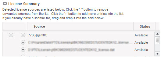

    Should you remove/uninstall a previously used Creo 2.0 license first? Are there specific instructions on how to do that? Thanks!

    You don't necessarily need to remove the old license, but it can be quickly removed during the software update.
    When running the installer, simply choose the Setup license option.
    In the following screens, you will have access to the License Summary. To remove a license, just click on the button next to a license to remove it. If you have a lab license and you'll be updating the license server, then there is not change required assuming the same machine will be used as the license server.
