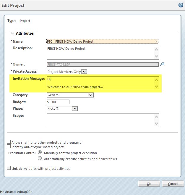

When inviting new team members to your Windchill Project, the inviation message will include the text entered in the "Invitation Message" box of your project. If you have a newly created/requested project, you should have a default invitation message. If you have a Project that was created in the past, you should take a look at the Invitation Message to make sure it exists and is something you want to share with others.
To change the Invitation Message, navigate to the Details page of your project as a Project Manager. Chose Actions, Edit Project and update the Invitation Message text area. It is a small input area, but you can put a lot of information in it. What I typically do is write the invitation in Notepad and then just copy/paste it into the box.
Once you're done, simply chose OK and any new invitations will now include your personal message.

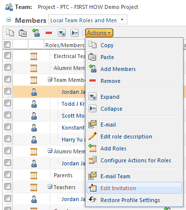

    October 26, 2014
    There is another quick way to check your project Invitation. From the team page, select the Edit Invitation option. This will bring you directly to the project's invitation message allowing you to make any necessary updates. Remember, this option is only available for Project Managers.
