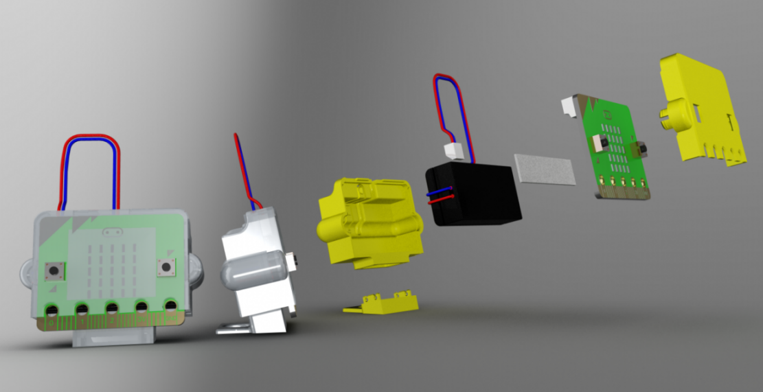

In Creo2 I had embedded the school logo and used rendered output to make working and presentation drawings. I can not do this  in Creo3 anyone got any pointers?
The attached file had to be exported as a  pdf and the  bitmap images added in a  3rd party programme.explode.png

    I've been having problems embedding bit map images within a Creo drawing.  The attached file shows what i wanted- Its a quick "essay" on developing a 3D printed case for the MicroBit-  I wanted to use  one of  the rendered images within Creo.  I ended up exporting the drawing as a pdf and then adding the bitmap images in illustrator
