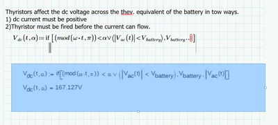

I'm trying to type this conditional statement and I don't know how to. Could someone please help me type this function?
I need a comma after V-battery and then an absolute value before the closing bracket, and PTC doesn't let me type that.

I tried that too, but still I can't get to what its supposed to be...

do not use square brackets, use parentheses.

and in my book, it is using square brackets.
Intro to power electronics and motor control page 718.
