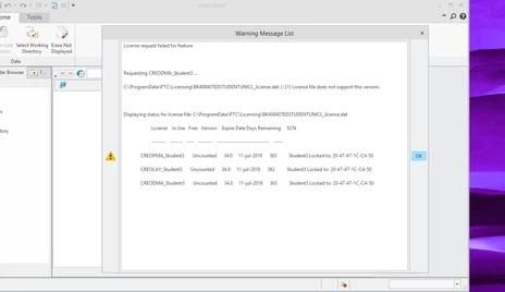

hello, when i start my creo it displays a warning message list...

July 12, 2017
please enlarge Warning window to show the whole text -OR- upload std.out file containing text.
MH
July 13, 2017
this is what i get..
July 13, 2017
Explanation of your problem: You installed Creo 4.0 and PTC gave you Creo 3.0 licenses. Unfortunately this is current status of "things". PTC did not update their license generator, therefore you cannot get Creo 4.0 licenses.
"Solution": Install Creo 3.0.
MH
