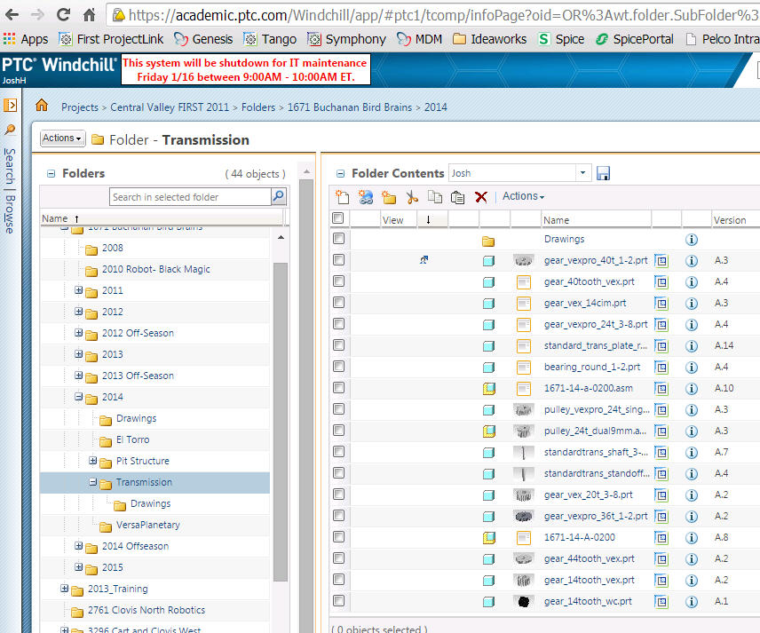

My personal suggestion would be to use Windchill. This allows versioning and locking of files. Keeps people from stepping on each other's toes and is a common storage method for big companies. You can register and find more information here http://www.ptc.com/communities/academic-program/k12/students/first/windchill-registration
