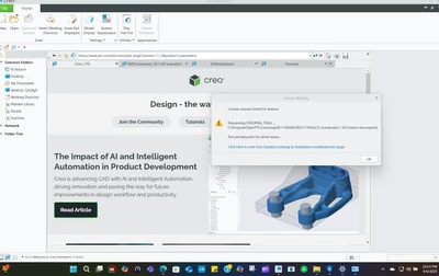

When I try to use Creo, I get the message Error -10
  • April 7, 2025
  • 507 views
I have installed the PTC Creo late February.
Now, when I try to use it I get the message shown in the picture below:
What is wrong?
I do not get it.
It looks like the PTC license has been cut.........
Any thoughts?
Thank you!
Best answer by MartinHanak
in February you installed TRIAL version. TRIAL license is valid for couple of days, only.
If you are student then you can use Student license.
1.] uninstall TRIAL version of Creo
2.] install Creo using information included in following documents.
https://apps.ptc.com/schools/references/install_creo11_schools_standard.pdf
https://apps.ptc.com/schools/references/install_creo11_unistudent_standard.pdf
