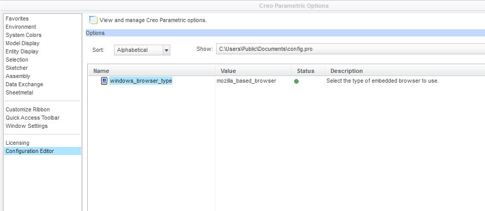

    @Peter, if you can't change IE11, get Firefox. Then, in Creo, go to "File", "Options", "Configuration Editor", "Add...". Then type "windows_browser_type" for the "Option name:" and "mozilla_based_browser" for the "Option value". Hit "OK", and then you may have to restart your Creo session.

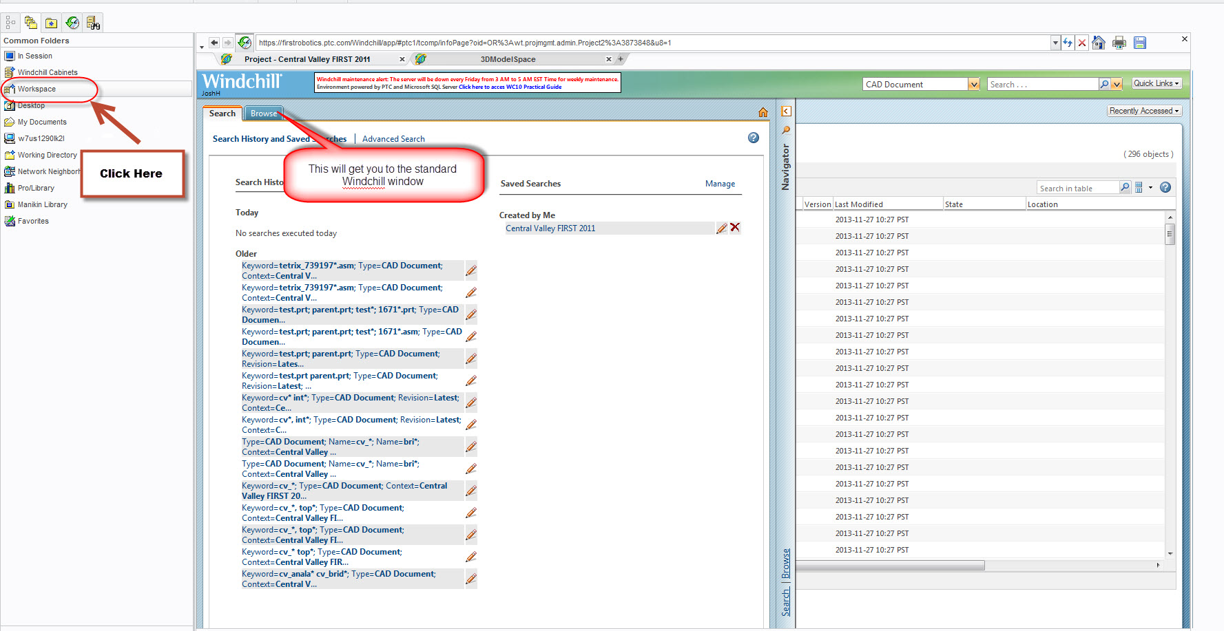

    Hi Peter,
    It looks like you're almost there! One problem you may be having is your browser. Scott can tell you the exact release that doesn't work, but I can tell that at least IE9 works. If nothing else, you can change your config to use Firefox.
    Try going to the window on the left of the screen you are showing and picking "Workspace".
    If you don't see that or the "Common Folders" tab, you may have to pick the little icon that looks like multiple folders. See attached image and let us know if that helps.
    Josh

    I am running Internet Explorer 11. My screen does not look like the screen you have posted. I do not have a "Common Folder" tab that appears. The attachment on the original posting has a copy of what I am seeing. I have google chrome already loaded... is there a way to try accessing Windchill with chrome... instead of IE? If I load Firefox... how do I select using firefox when trying to access Windchill from CREO. Firefox may be a problem... since all of the school PC's only have IE and Google Chrome already loaded.
    Dec 17, 2013 1:22 AM UTC
    Ah-ha, that will do it. No mas IE11. Not supported with the current version of Windchill setup for FIRST. What are you using for an OS? Is downgrading IE to 10 possible?

    Peter,
    Check the root folder of your project. I was able to connect, create a a workspace, create a new CAD model, save it to the new workspace and check it in to your project. The file is FRC3172-SM-TEST_CAD_MODEL.
    Josh is right on with his guidance. Try picking the Workspace option in the Common Folders tab of the Navigator. This will always bring you to the "Default" workspace.
