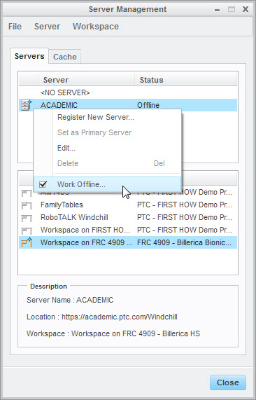

Windchill Not Working - Message: database 'tempdb' is full
Windchill appears to be non-functioning at 4:50PM CST
We have internet, and are online with windchil, but cannot see any files in windchill.
Does anyone know if it's a windchill issue, or local issue?

    Fixed! The tempdb has been cleared and resized and the server has been restarted to get everyone back online. Apologies for the down time, especially during the FRC build season. It was not our intention and PTC will continue to monitor and maintain this server to make sure it has the high availability everyone has come to expect.

    Yep, we're all stuck here.  We can see all of our folders (and a few parts we stored outside the CAD Models folder), but everything else is empty.  I am getting the error: "ERROR: The transaction log for database 'tempdb' is full due to 'ACTIVE_TRANSACTION'.

    Sorry about that, it looks like we scheduled the DB resizing a day late. The error message is:
    Message:The transaction log for database 'tempdb' is full due to 'ACTIVE_TRANSACTION'.
    This should be resolved by tomorrow's restart that will give the admin's time to resize the tempdb.
    Apologies for the outage. We do our best to monitor and maintain the DB sizes to make sure this does not happen. I'll chat with the admins to see if we can adjust the monitoring threshold to make sure there is enough time to react without causing down time.

    For everyone out there - I was still having issues even after Scott's message this morning that the server was restarted.  I deleted the server from my server management, closed Creo, reopened Creo, reopened server management, readded the server and things were back to normal.
    Scott - if you have a better method to fix that, please chime in   I'm going to work through that fix with the rest of our team members.

    By default, the Creo Server Mgr will report the server as "offline" since it was technically offline yesterday. When you start Creo, just right mouse click on the server name and remove the "offline" checkmark. This will sync you local workspaces and get you back online. You should not need to remove and then add the server connection.
