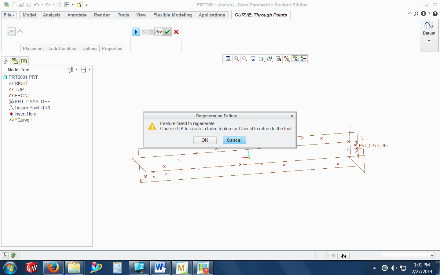

Everytime we try to create the Wing in CREO 2.0 using the instructions given in MathCAD.
This was there error we kept on getting.
Has anyone else experienced this problem and how did they fix it?

    It appears that you are trying to generate a wing by importing airfoil coordinates. The erros you are seeing usually occurs when the file you are importing is not formatted correctly. You can try to fix the file format. Alternatively you can design the wing using coordinate points directly within CREO.
    -Dr. Khalid

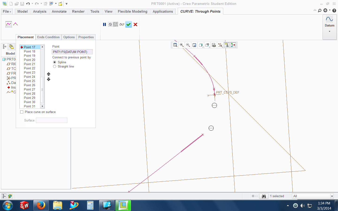

    March 3, 2014
    I was able to make the curve, but I could not find a way, or a tutorial that taught me, how to connect the final two points
