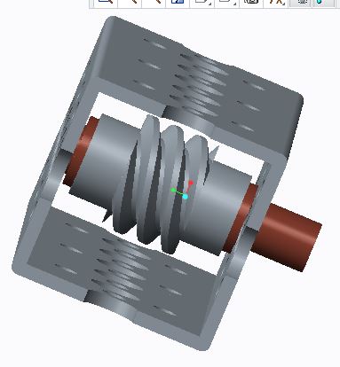

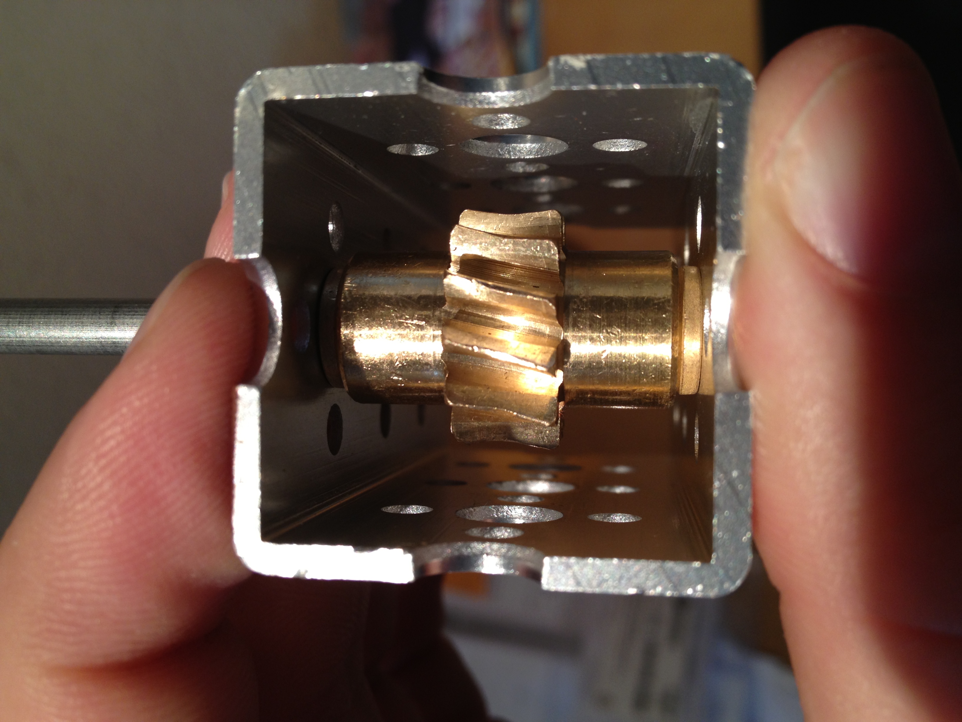

This year First has allowed a number of different "new" parts. I've been slowly working on designing some of them for our schools 6 teams to work with, but the corkscrew inside the WormDriveGearbox is baffleing me.
Has anyone designed this yet? Are there any tutorials on this? Any recommendations?
Thanks for your help.
IMG_1115.JPGThis worm wheel should be pretty simple to make by creating the teeth and patterning them around a cylindar .

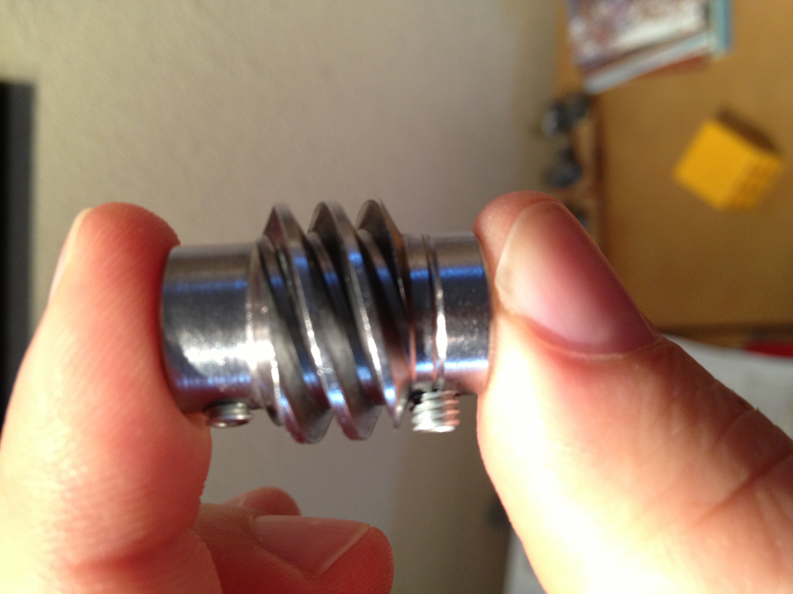

IMG_1116.JPGThe worm gear (corkscrew) is what I'm unsure of. It has two spiraling sets that run parallel to each other. If anyone has the time and wants to do a screenshare with me, I'd appreciate your time.

    You will love this site:
    https://sdp-si.com/eStore/Catalog/Group/390
    They allow you to download native Pro|E files in several full versions.
    If nothing else, download the STEP files and study them.
    rpackham1-VisitorAuthor
    Nov 3, 2013 10:17 PM UTC
    This is a great resource. Thanks for sharing. I just need a quick tutorial on how to create a Helical sweep.
    Nov 3, 2013 10:36 PM UTC
    Nov 4, 2013 4:03 AM UTC
    Antonius, That link, and the video were a great help. I also found this video which was perfect: http://youtu.be/dhq6Z_-CPUE
    Here is what I designed:
    It was quite the learning experience, But that's what this whole journey is all about.
    I'll post the remainder of the project when done.
    Thanks.....
