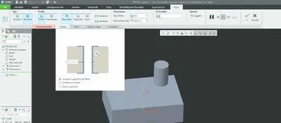

Good morning,
I'm using the Educational version to learn how to use Creo 9.0 and when I try to make a hole with ISO thread, the measurements are wrong, how can I fix it?
Example: M10x1.5 hole the pre-hole is 8.5.. what is 0.3346?
I hope to get help.
Thank you,
Emanuele
Thank you,
Emanuele
Best answer by MartinHanak
0.3346 inches = 8.5 mm
You created model with inches set as length unit. Instead of it create model with millimeters set as length unit.
August 3, 2023

Perfect! Thanks a lot, I really have a lot to learn😊
