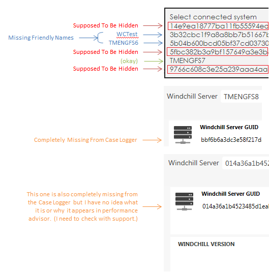

TomU
Apr 28, 2017 3:59 PM UTC
No, there haven't been any changes since this discussion started.  I did have a case last year to remove several old GUIDs from performance advisor since there was no way for me to hide them.  (C13198448)  I just checked and sure enough, three of the GUIDs shown in the case logger list are these same three old (supposedly removed) GUIDs.  Apparently whatever change was made to performance advisor to hide these doesn't also hide them from the case logger.
There seems to be three distinct issues here:
  1. Old GUIDs that have been removed from performance advisor still appear in the case logger list.
  2. Newer GUIDs (in the last 12 months) that do appear in performance advisor are not available in the case logger list.
  3. Some of the friendly names that have been created in performance advisor do not show their friendly names in the case logger list.

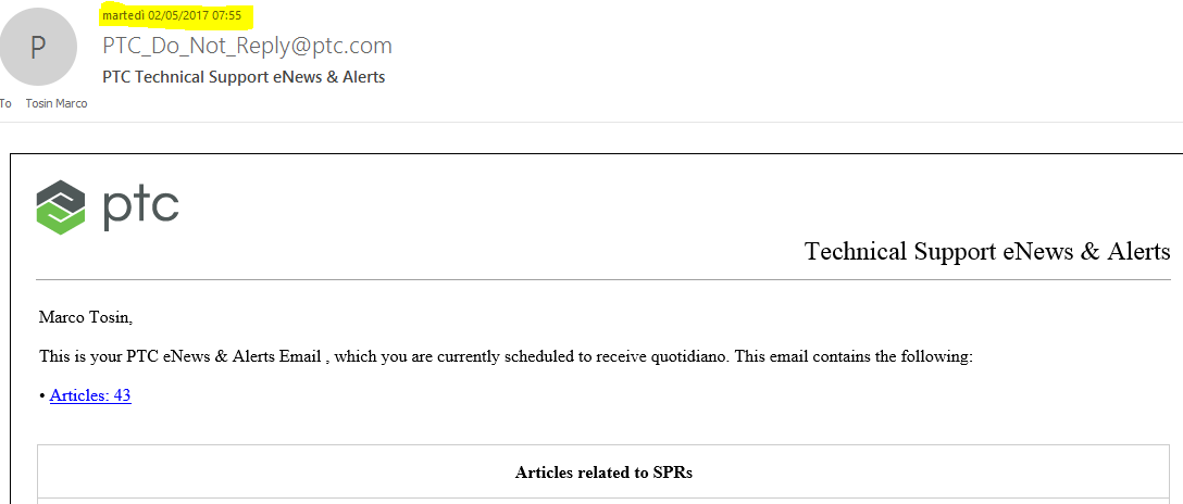

MarcoTosin
May 2, 2017 9:50 AM UTC
Hi Peter,

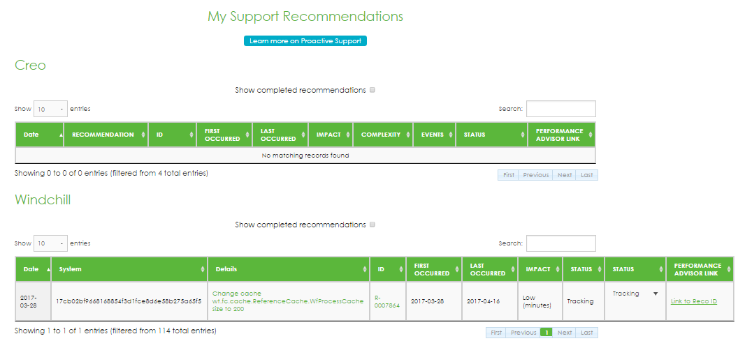

yesterday I received an email WITH 10 recommendation (1 new and 9 completed).
Today I received an email WITHOUT any recommendation, despite 1 of them was still new (but is for a dev server not for a production).
See attached images.
Marco

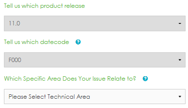

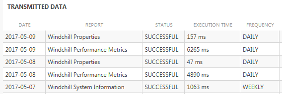

TomU
May 9, 2017 9:10 PM UTC
Peter Case‌, another update for you.  During case creation today we noticed that the case creator is using incorrect values for the connected systems.  For example, here are snippets from Windchill Performance Advisor for one of our systems.  Notice the Windchill Release:
Here is what we see during case creation:
The datecode is completely wrong, and it's not like this is a recent change.  We've been running this datecode for months now and the data is being refreshed on the Performance Advisor site nightly.
Any idea where the case creator is getting the wrong information from?

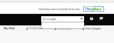

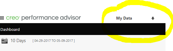

MarcoTosin
May 10, 2017 9:05 AM UTC
Hi Peter,
there are a couple of other broken things since yesterday.
If you refresh PA for Creo dashboard none of the gadgets are visible.
To see them you have to simulate to add gadgets and close that window.
In dashboard window there is also something new (see attached image).
In the right upper corner it is impossible to select.
Marco
PeterCaseCommunity ManagerAuthor
Community Manager
May 10, 2017 6:43 PM UTC
Tom Uminn
Our systems team found the root cause and it's in fact related to the missing CPS issue which you also highlighted here.
As our incremental cron is not finding the equivalent release info on the system on which we create our cache, it is inserting F000.
Sorry that this has taken longer than expected to fix. With the wider impact that this is now having, I'm escalating the issue with missing releases.
Peter.
Community Manager
May 12, 2017 10:48 AM UTC
Hello Marco Tosin‌,
Sorry for my delay here. I've been in touch with the team who manage the Performance Advisor pages and can share an update:
- A new release of the PA was deployed this week to add some sharing features
- The team are aware of these issues and are working on them
- We can expect a fix early next week
If it helps, the PA seems to be working on Firefox build 51.0.1 for me. The drop-down menu top right was available and I could navigate to my Dashboard.
Debug on IE is showing me the error: "Unable to get property 'Widgets' of undefined or null reference"
Peter
Community Manager
May 15, 2017 6:52 AM UTC
Good morning Marco Tosin‌
The Creo Performance Advisor development team have confirmed that the blank dashboard issue is now fixed. I tried this morning and it looks good here.
Please let us know if you continue to see any problems.
Peter.
MarcoTosin
May 16, 2017 8:30 AM UTC
Hi Peter,
sorry for my late response but I was out of office for a vacation and I'm returned just this morning.
I confirm that all is working right and I can also see two new voices in the drop down list.
Thanks.
Marco
