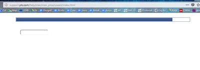

Several people at my company and I have had a LOT of trouble getting the help web page to load for Creo 4.0.
I have tried it on Chrome, IE 11, Firefox 57, on my company network and at home.  Sometimes it loads quickly, but often it fails to load at all, other times it takes 90 seconds or so.
PTC says I am the only one that has this issue. Please try it on multiple browsers on various networks and post your results.
 http://support.ptc.com/help/creo/creo_pma/usascii/index.html

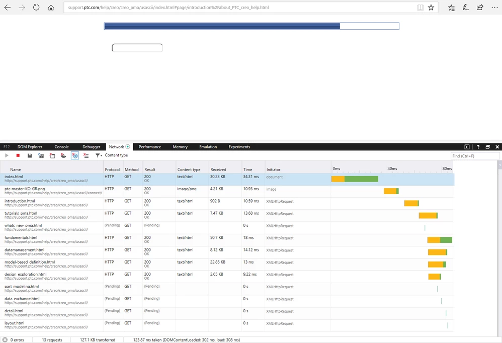

Jan 9, 2018 3:56 PM UTC
Yep, same issue.  Sometimes it loads and other times it doesn't.
2-Explorer
Jan 9, 2018 5:03 PM UTC
Interesting. I have a tab open to the help and it shifts from topic to topic very fast. But I open a new tab and it freezes at partially loaded. So it may be choking on loading the javascript that is then used to load the page contents or on google analytics. It looks like the server at PTC is failing to send the .html files for each of the sections. There's a thing called Incapsula_resource....js that loads, and unzips, that seems to load all the rest, or not. I'd say it's a failure on the PTC end.
