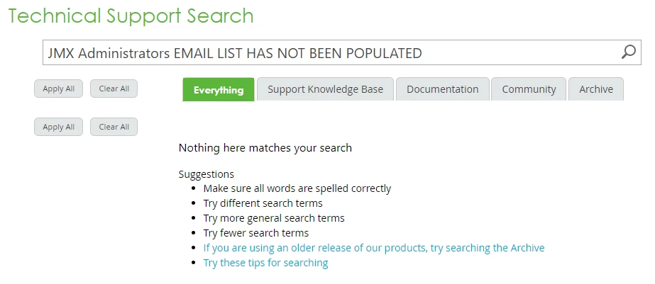

Copying and pasting this into the search results returns nothing:

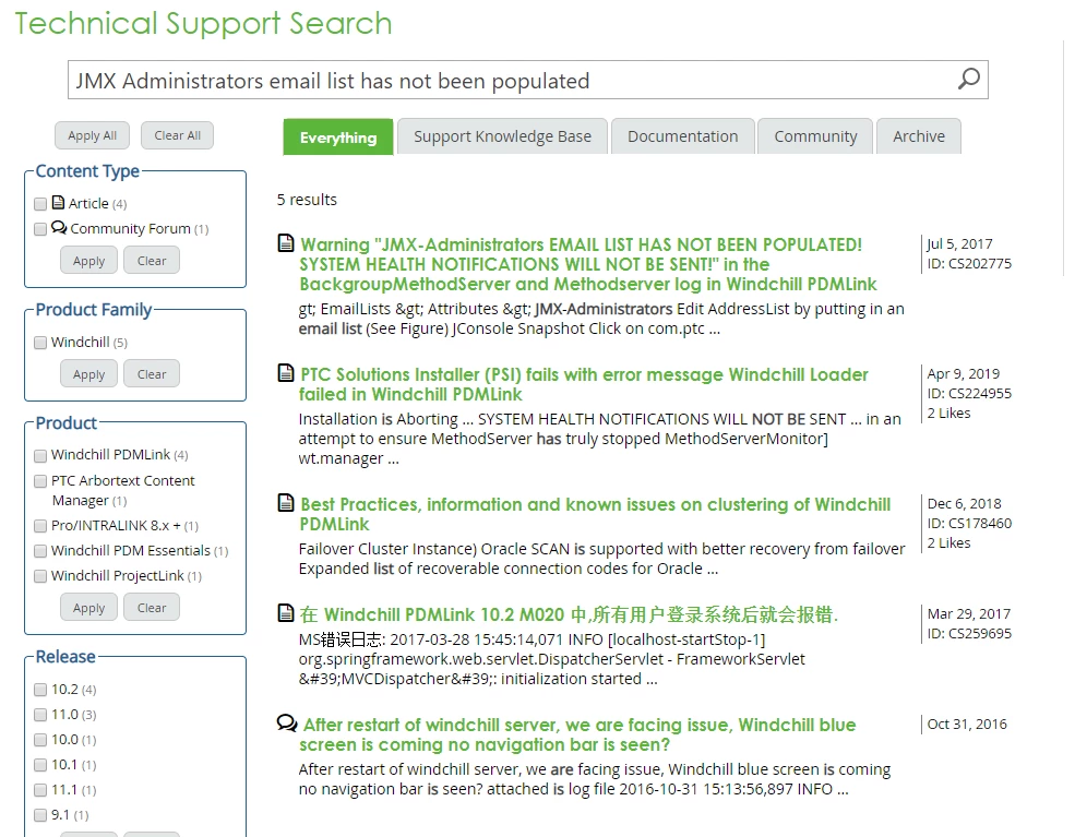

Changing the last six words to not be capitalized allows the search to return the correct article:

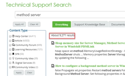

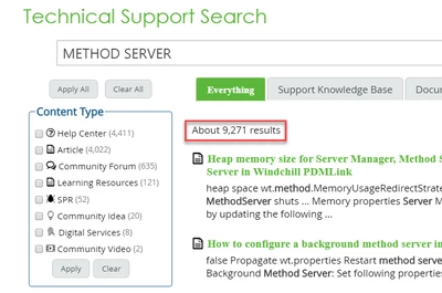

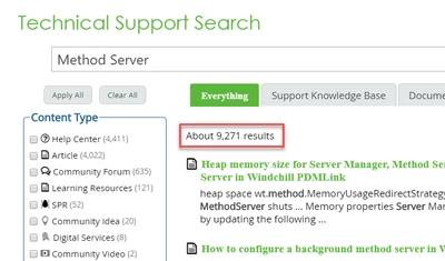

Theoretically, the Search engine we are using is not case sensitive. All letters, regardless of how you enter them, are understood as lower case. The search engine matches words and concepts regardless of capitalization.
For example: a search on “METHOD SERVER” retrieves the same amount of results as “method server” or “Method Server”.
Our engineers will look into this issue and at the same time please use quotation mark or lower case for your search query in order to increase match. As soon as the root cause is identified, I will update on your post.

For those who may be watching this thread, the problem is the word "NOT" in the search string.
JMX-Administrators EMAIL LIST HAS NOT BEEN POPULATED
When capitalized the 'NOT' becomes a Boolean operator and is supposed to alter the search behavior to exclude anything after it.

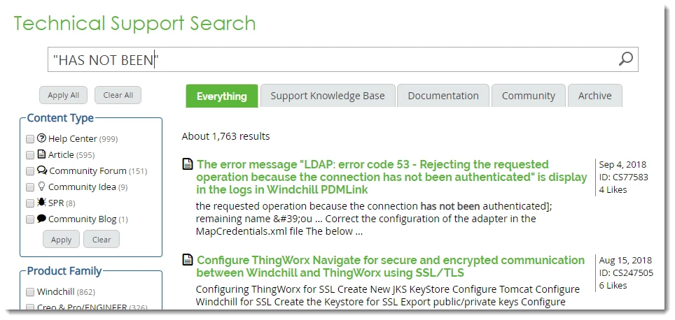

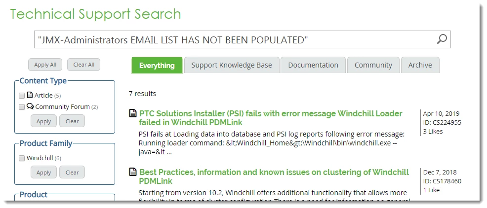

Feb 4, 2020 11:32 AM UTC
As already mentioned by Tom, the word NOT is being treated as a Boolean operator and hence the issue. Before specifying more details about the behavior, I'd just highlight the workaround for such a scenario.
When using any Boolean operator in your query in CAPS, make sure the query is surrounded by quotes as seen below.
You can also narrow down the search query to include more results as seen below. When quotes is used around a query it will search for the exact match in the results.

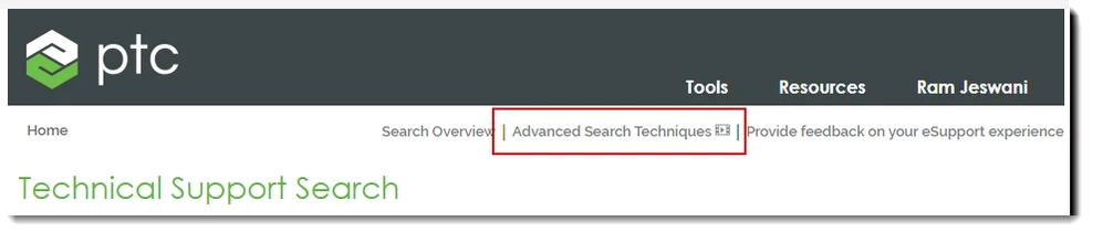

Details about the Boolean operators has already been mentioned in the Advanced Search Techniques page link of which is present on the homepage.
The NOT operator does work well. It is recommended to use this operator with properties. However, it should work fine with text expressions as well.
Lastly, I understand some of the information mentioned here is not present on the techniques page. We'll work on it and make sure the right details are present in there soon enough.
