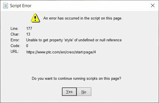

Script Error from PTC's Start Page
Last week my users starting getting this script error when they start Creo.  Is that something PTC needs to fix?  I know I can add the config option web_browser_homepage or js_error_policy but I don't think that should be the solution.  Isn't this something on PTC's site?

I put in a case log. PTC support gave me a CS# to look at. What a joke. This CSArticle - CS67489 is from 2012. I am using IE 11. This has nothing to do with the current errors.
Jul 16, 2019 12:32 PM UTC
Just add the following to your config.pro. I am using IE 11. The js errors don't show anymore...good or bad. Set config.pro option js_error_policy to suppress_continue

We have had these for years. It appears to be something with the registry settings tied to the browser as tied to xtop.exe.
Internet Explorer 11.0 clients: Add the following registry keys with values of 11000 (decimal) or 2af8 (hex) via regedit or other method
​Windows Registry Editor Version 5.00
[HKEY_LOCAL_MACHINE\SOFTWARE\Microsoft\Internet Explorer\MAIN\FeatureControl\FEATURE_BROWSER_EMULATION]
"xtop.exe"=dword:00002af8
"ptc_ie_server.exe"=dword:00002af8
"creoagent.exe"=dword:00002af8
"uwgm_client.exe"=dword:00002af8
"genlwsc.exe"=dword:00002af8
[HKEY_CURRENT_USER\SOFTWARE\Microsoft\Internet Explorer\MAIN\FeatureControl\FEATURE_BROWSER_EMULATION]
Article - CS23522

I know in our case it was because of some Windows policies that our IT had pushed out. This has been around for quite some time if you look at the case I linked you can see that it has been around as an issue for some people as far back as 2011 when the case was first crated with IE8 and has been updated right up to this past May to keep up with the browsers. There's nothing basically wrong with the PTC site in question and you can see that by opening the URL in a standalone browser.
