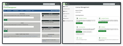

Transitioning from PTC's legacy License Management web tool homepage (left) to the new, user-friendly Manage Licensing app (right).

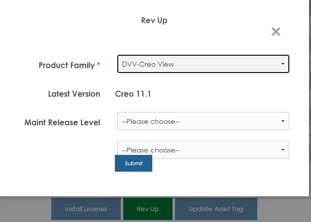

One of the most common things I do is Rev Up when new versions of software become available.
I have not found the equivalent to "Rev Up" anywhere in the "improved" app or the faq or the help videos that are available.
Please provide a link to a document or video that shows how to do this.
Community Manager
June 7, 2025
Hi @RandyJones ,
The step-by-step to manage your license versions, based on the eligible versions available to you, is found in the second half of the "Advanced Configuration" video.
Click by click, here's how:
  • Licensing Hosts # [Select your Host] # Detailed View
  • [Review set version and available eligible versions]
  • # Manage Versions # [Select your new version] # Modify Versions
This then allows you you retrieve your updated license file for the host / product combination.
In case you have any difficulties, or don't see what you're expecting, our License Management team can help you further.
Many thanks,
Peter.

Thanks for the pointer. That video is the one video I did not watch because the link is titled "Advanced Configuration in Access Enablement" which has nothing to do with the content of the video.
I have opened a case with the License Management team because I do not have the "Manage Versions" selection.

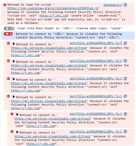

We are currently unable to access the PTC Licensing Dashboard after the update to the new app (https://my.ptc.com/licensing/dashboard). The page fails to load and displays the following errors in the browser console (screenshot attached).
Content-Security-Policy: The page’s settings blocked the loading of a resource (connect-src) at https://dc.services.visualstudio.com/v2/track because it violates the following directive: connect-src 'self' https://*.ptc.com.
Refused to load the script 'https://cdn.cookielaw.org/scripttemplates/otSDKStub.js' because it violates the following Content Security Policy directive: "script-src 'self' https://*.ptc.com 'unsafe-inline' 'unsafe-eval'". Note that 'script-src-elem' was not explicitly set, so 'script-src' is used as a fallback.
This issue persists across multiple browsers (Chrome, Firefox, Edge), devices, and networks. We have attempted the following troubleshooting steps without success:
- Cleared browser cache and cookies
- Used incognito/private browsing modes
- Disabled all browser extensions
- Tried from devices that have never accessed the site before
It appears this may be a server-side configuration issue related to Content Security Policy settings. Has anyone else encountered similar issues?
MaxPoe10-MarbleAuthor
June 11, 2025
Hi @ECampbell ,
Yes we have received reports of the same issue from some other users.  We are actively working on a solution and hope to have it resolved within 24 hours.
In the meantime, there is a workaround.  When you login, you see the dashboard behind a spinning wheel which never stops, right?
  1.  While the page is loading and the wheel is spinning, change the URL to either of the following:
    1. https://my.ptc.com/licensing/product-license
    2. https://my.ptc.com/licensing/manage-host/host-list
The Product Licenses page or Host list respectively should load.
Thank you for your patience and again we are working to get this resolved ASAP.
June 11, 2025
FYI @ECampbell the spinning wheel issue has been resolved.  You should be able to access the tool without error now.  Please let me know if you still face any trouble.

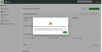

无论检索哪个 License 文件,都会报错。
错误消息如下:
生成许可证文件时出现问题:未定义
,请在几分钟内重试。如果错误仍然存在,请向 PTC 提交一个问题,包括错误消息和上面的参考 ID。
您能帮忙看看这个问题吗?我打开了一个 CASE,但没有响应。响应速度太慢。我现在没有许可证文件,这使得我无法使用该软件
June 12, 2025
We have received a few reports of customers getting this error message after clicking to retrieve the license file and our IT team is actively looking into it.  We have been unable to reproduce the issue on our side, I am able to generate license files under your Account without error.  For that reason, our AE team and IT are reaching out to some customers to do a screenshare and try to figure out what is wrong.  Do you perhaps have downloads disabled on your browser?
In the meantime if you need a license file to be generated urgently, please open a ticket at My PTC Assistant and select an option under License Management.  Our AE team will be able to get the file to you.
 PTC | My PTC Assistant
Thank you,
Max
3-Newcomer
June 13, 2025
Hello, the case I opened has been replied to. The reason has been found. It was caused by the fact that the name of my PTC Web Account was in Chinese. After I modified it to pure English, the license file could be retrieved successfully
