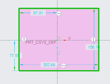

Trying to work though exercise 4 and 5 along with video. When adding a dimension to sketch, nothing comes up.

Do you even see the weak dimensions that should display by default for the sketch? Like this?

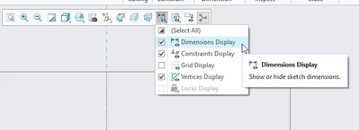

If you don't see even these dimensions then you probably don't have dimension display turned on in Sketcher mode.
In the In Graphics toolbar (located at the top of the graphics window by default), make sure that dimension display is enabled:

The was very helpful. thank you....
