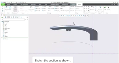

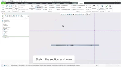

this is pretty frustrating as the training is not explaining. To sketch the "section as shown"- then it magically flips to the inside view.. no explanation. How do you rotate or flip like that? Is there a "hot key"?

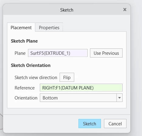

When you create a sketch, the orientation for that sketch view is based on both the reference and orientation in the Sketch Setup.
You can flip this, or modify it based on changing some of the variables in your sketch setup like the Reference or the Orientation. You can access this either upon sketch creation or in the sketch by clicking Sketch setup.

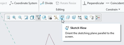

While in Sketcher, to reorient the graphics window so that the sketch plane becomes parallel with your monitor you click Sketch View from the In Graphics toolbar:
By default, when you enter Sketcher, Creo retains the current model orientation. There is a config.pro setting that enables this default behavior to be switched such that when you enter Sketcher the system automatically reorients the model to the Sketch View.
This information is covered in Fundamentals of Solid Modeling 1 in the theory part Create Sketch Features. (page 46 of the PDF).

I understand the sketch view part and button- that was not my ask. When you hit that and it needs rotated 90 degrees, or maybe flipped 180 degrees front to rear- how does that happen please?
Oobee12-AmethystAnswer
Nov 14, 2025 6:49 PM UTC
