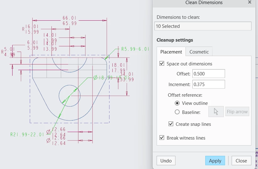

You can try a couple things, I find that selecting my dimensions and clicking Cleanup Dimension (right-click and hold after selecting the dimensions) is a decently fast way to space things out with consistency. It doesn't apply to angular or radial dimensions, but it does make a good first pass. Certain things might still need to be adjusted like witness lines.
 Cleanup DimensionsCleanup Dimensions

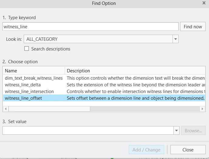

You can control witness line offset globally with the detail option 'witness_line_offset'
Hope that helps!
