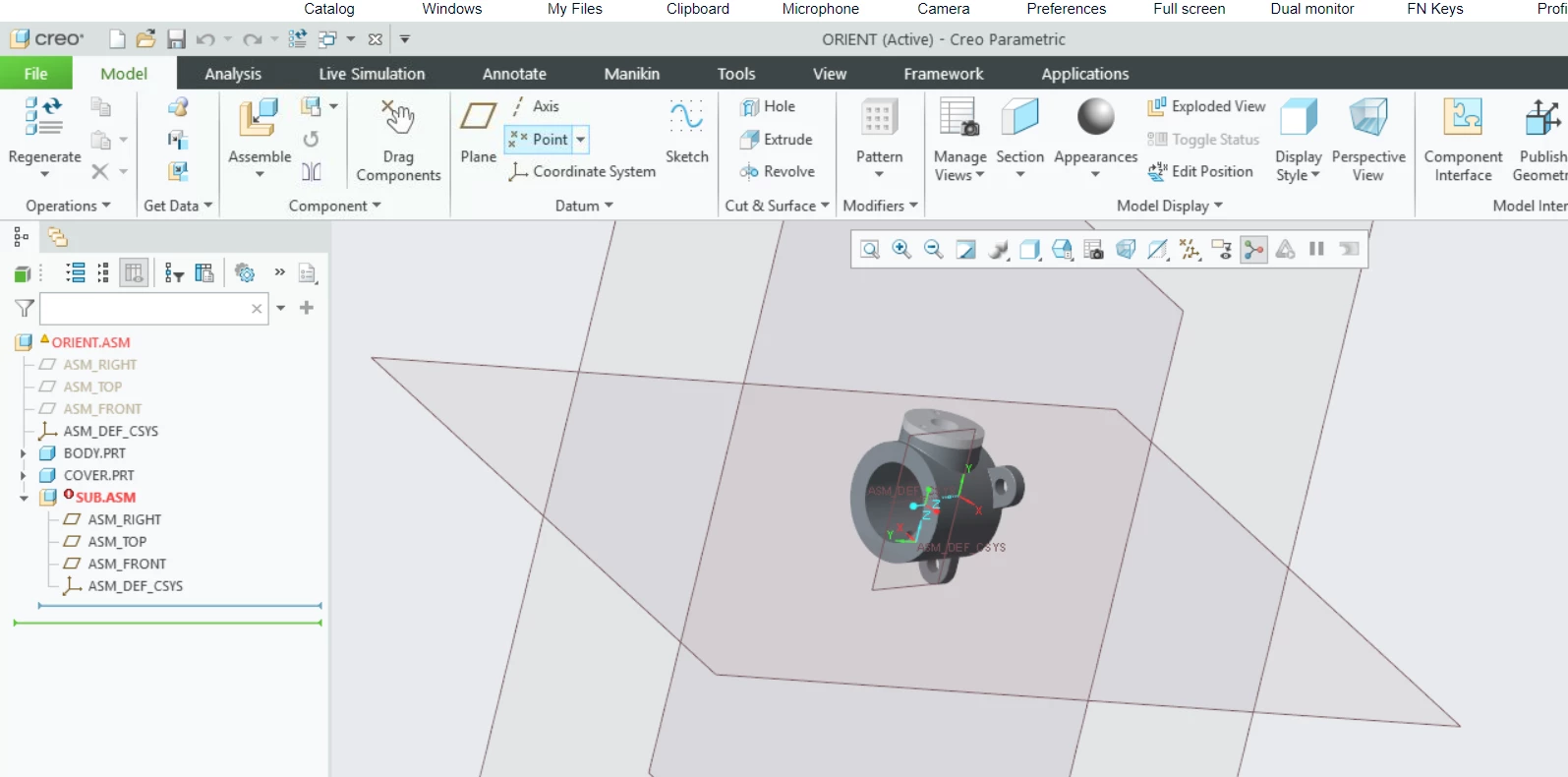

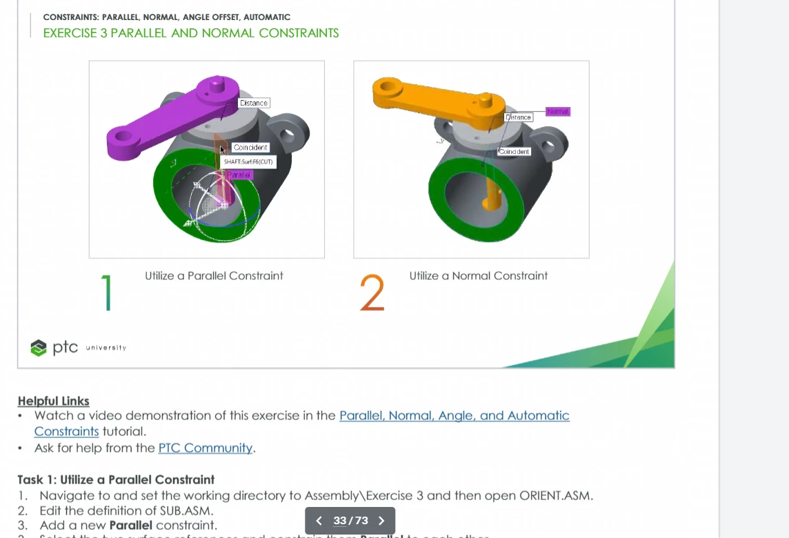

My directory for Exercise 3 is missing a part
I'm getting an error because CRFD ASBY Creo_Fundamentals of Assembly doesn't have the wrench part for exercise 3
Jun 27, 2024 6:00 PM UTC
It looks like this has happened before. It's probably too late now, but if you encounter this again, try closing the assembly, select Erase Not Displayed, and reopen the assembly.
