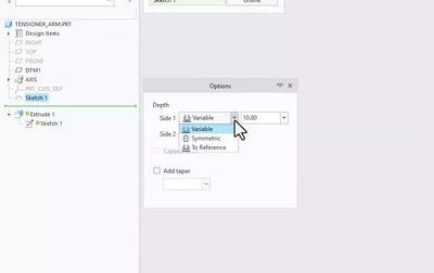

on exercise 2 edit definition in creo fundamentals of modeling, what is "side 1" and "side 2"?
 I dont see them in the model tree.
Jan 24, 2024 2:33 PM UTC
Side 1 and Side 2 refer to the directions of the extrude.  When you are editing the extrude, select the options tab that shows up next to the placement tab to see the options for Side 1 and Side 2 depth.

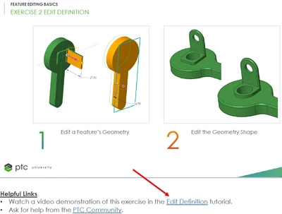

Hope the issue is resolved. If not every exercise has a video tutorial to guide you on exercise completion. Video for this exercise is here.

You will see Side 1 and Side 2  in the Options window after you edit the definition of Extrude 1.
