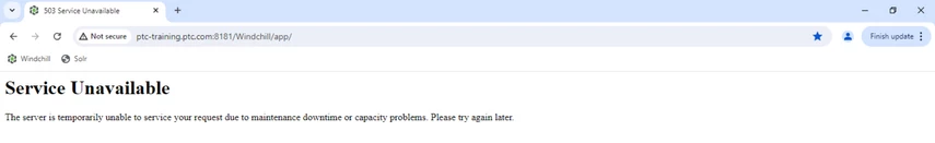

I'm taking the fundamentals of engineering bill of materials (eBOM) whindchill course, and when i try to access the virtual machine to preform an exercise I got message that the service unavailable due to maintenance downtime or capacity problem. could you please assist me resolving this issue.

I know this won't help you now that the class is over, but I hope it can help others who experience this.
You received this message shown below because the Windchill server was not yet online. If you launch the Windchill client icon from the desktop, a CMD window appears when the server is not yet ready. Once it's ready, the web browser will open, ready for you to log in.
