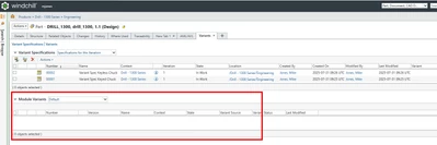

I am on exercise 7 now and run into a discrepancy between training material and Windchill.
When creating a variant, I go to Actions->Configure.
The Configure window that I see on the video recording has 5 stages with the last one being "Module Variant".
When I try to do the same in Windchill I only get 4 stages, with the last being Variant Specification.
So I create Variant specs, but no actual Module Variants it seems:
 Have I missed a step or something?
7-Bedrock
Jul 31, 2025 1:11 PM UTC
Please, may you try to check-In the Configurable BOM?
8-Gravel
Jul 31, 2025 2:18 PM UTC
No that you mention it, it does say at the end of Exercise 6 to check in and checkout objects. However, I ignored it as I have not check out anything.
I cannot test it now as my session expired, but I will try to re-do everything tomorrow and let you know.
