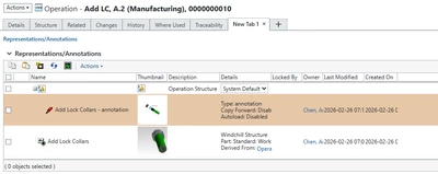

hello,
I have a problem for the last exercise: when I generate work instructions I have no illustration for the Add LC operation.
I did create the annotation at the previous step but it is not displayed in the work instruction.

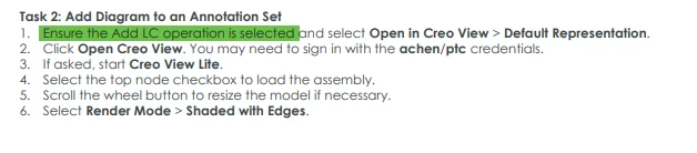

I would like to help but I need some more information.
Are you talking about Task 1 of the Instructor Demo on page 60 of the Training Guide? Did you watch the video of the Demonstration to see if you matched the steps? What was the last Task and step that you believe were completed correctly?
Did you have any trouble with the Instructor Demo on page 52-53 of the Training Guide? Is it possible that you did not select the Add LC operation before you opened Creo View?
