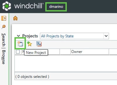

Feb 10, 2026 7:12 AM UTC
I'm not getting the option to create New Project
Do we need to assign any license to Project creator?
Feb 10, 2026 10:45 AM UTC
Just to confirm, is this related to Exercise 1 (Create a Project)?
If so, the provided user dmarino / ptc does have the required permissions to create a project, so this doesn’t appear to be a licensing or access issue. I’ve tested this on my side and wasn’t able to reproduce the problem—the option is available as expected.
To help us investigate further, could you please share the exact steps you followed leading up to this issue? That will help us try to reproduce it and see what might be going on.
