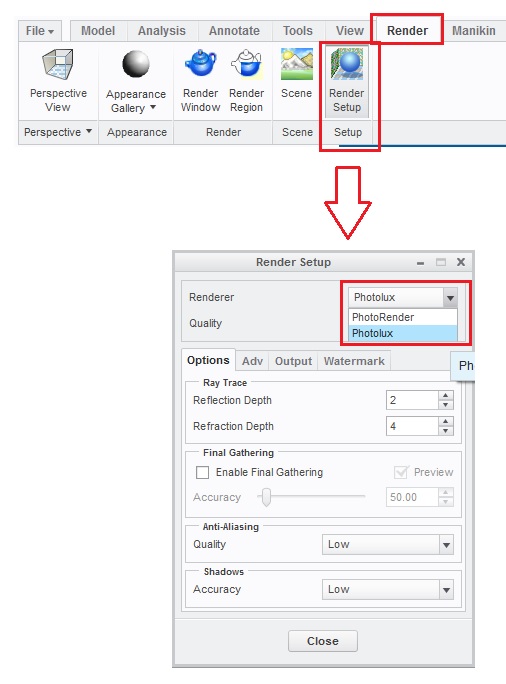

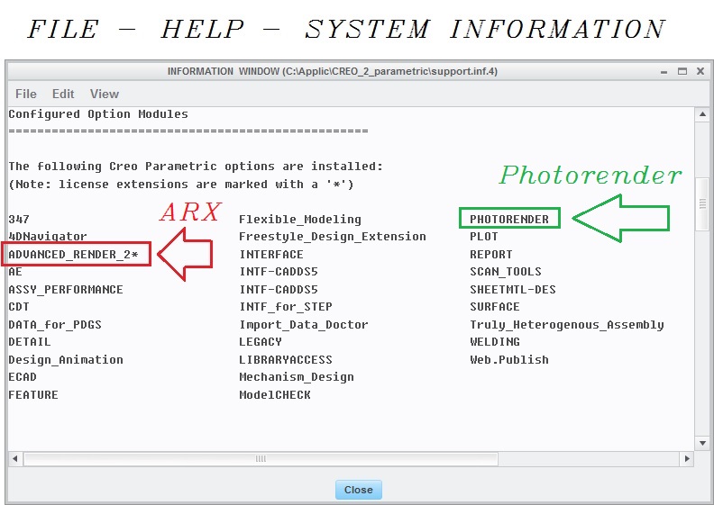

In training institute we are using creo academic version M010. but i want to use creo advanced rendering. how do i check whether its having ARX or not? also tell me what is the advantage of ARX while comparing to normal creo version?

l know 2 ways how to check your render licence. Please se pictures below.
