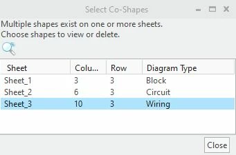

In Creo Schematics for a particular component, how is the block, circuit and wiring drawing linked?
If I place all three drawings on three different types of sheet as mentioned and select the co shapes then all three are visible on the pop up window (see the attached file).
However, if I modify any one drawing then the other drawings are not updated automatically, I have to manually update every associated drawing.

Hi Supriya20,
As per the below help document, this functionality is available for CID to WID design only.
http://support.ptc.com/help/creo/creo_schem/usascii/#page/Schematics_hc%2FSchematics_topic2.html%23
Could you please share more information and your scenario so we can replicate the issue at our end and further investigate?
