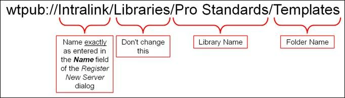

We put our formats and templates in a Windchill library and using the following configs it works fine - no waiting at all:
pro_format_dir wtpub://Intralink/Libraries/Pro Standards/Formats
start_model_dir wtpub://Intralink/Libraries/Pro Standards/Templates
It's very easy to get the syntax wrong with these paths:
[cid:image002.jpg@01CF41AA.201BC3D0]
For these config paths to work users MUST properly register with the server. In the example above the server name
[cid:image003.jpg@01CF41AA.201BC3D0]
The following statement by Don is also our experience:
" There is no delay at all when users create drawings. It defaults to EMPTY instead of USE TEMPLATE, but once they change that radio button the templates are all listed and they can pick one before continuing with their drawing creation. Once they choose the template they want to use and pick the OK button, there is no delay."
