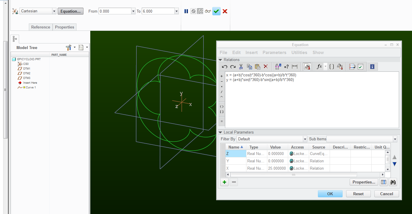

I'd use the curve by equation feature.  Then you can trace the curve entities in your sketch...
Equations for Curves (and more)
Or this one: http://mathworld.wolfram.com/Epicycloid.html
Here's an example in Creo 2.0:

You'll probably also want to construct one lobe and pattern if you're looking to create a solid. You may also need to adjust the angle used in the equations.
