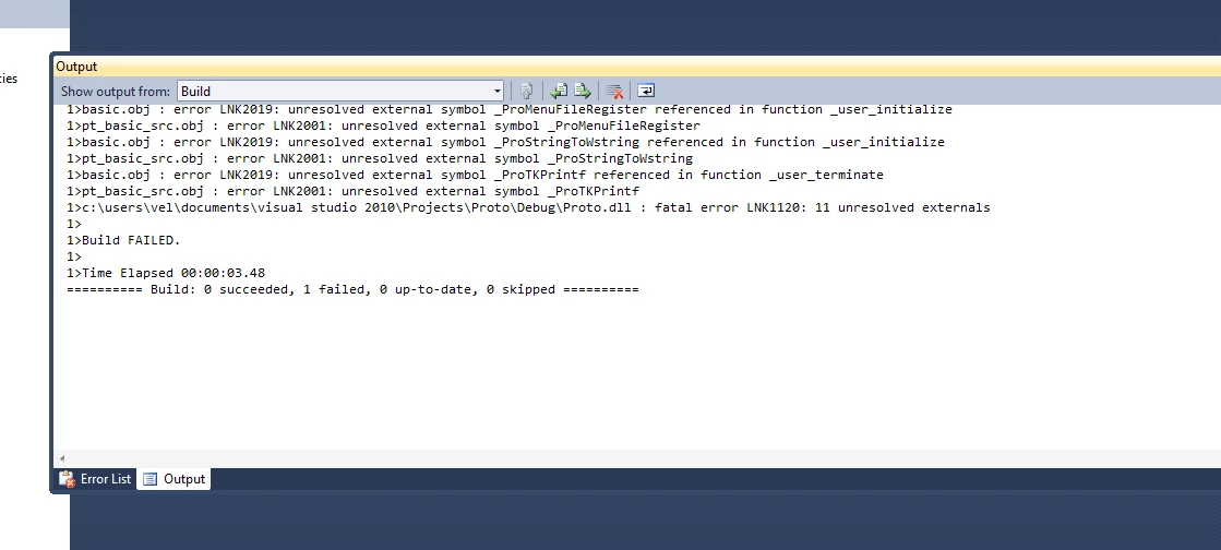

You need to link against the proper toolkit library.
In VS10, in project properties / Linker / Input / Additional Dependecies add <creo_install_dir>\Common Files\M120\protoolkit\x86e_win64\obj\protk_dll.lib
There may be more missing libraries but I can't say from the picture you posted. Try to build the project and then upload the log file generated by visual studio.

               Thank you for your reply. Am using Toolkit C++. I tried to open file in VS 2010. When I try to build that it shows so many errors. I have add additional includes and linkers.

All of the errors shown in the picture that you attached are caused by Visual studio linker not finding the toolkit libraries.
In the user guide look for "Running the Microsoft Visual Studio Solution" (Fundamentals / Installing Creo Parametric TOOLKIT / Testing the Creo Parametric TOOLKIT Installation / Running the Microsoft Visual Studio Solution) section. It gives you instructions how to build the toolkit application from Visual Studio.
