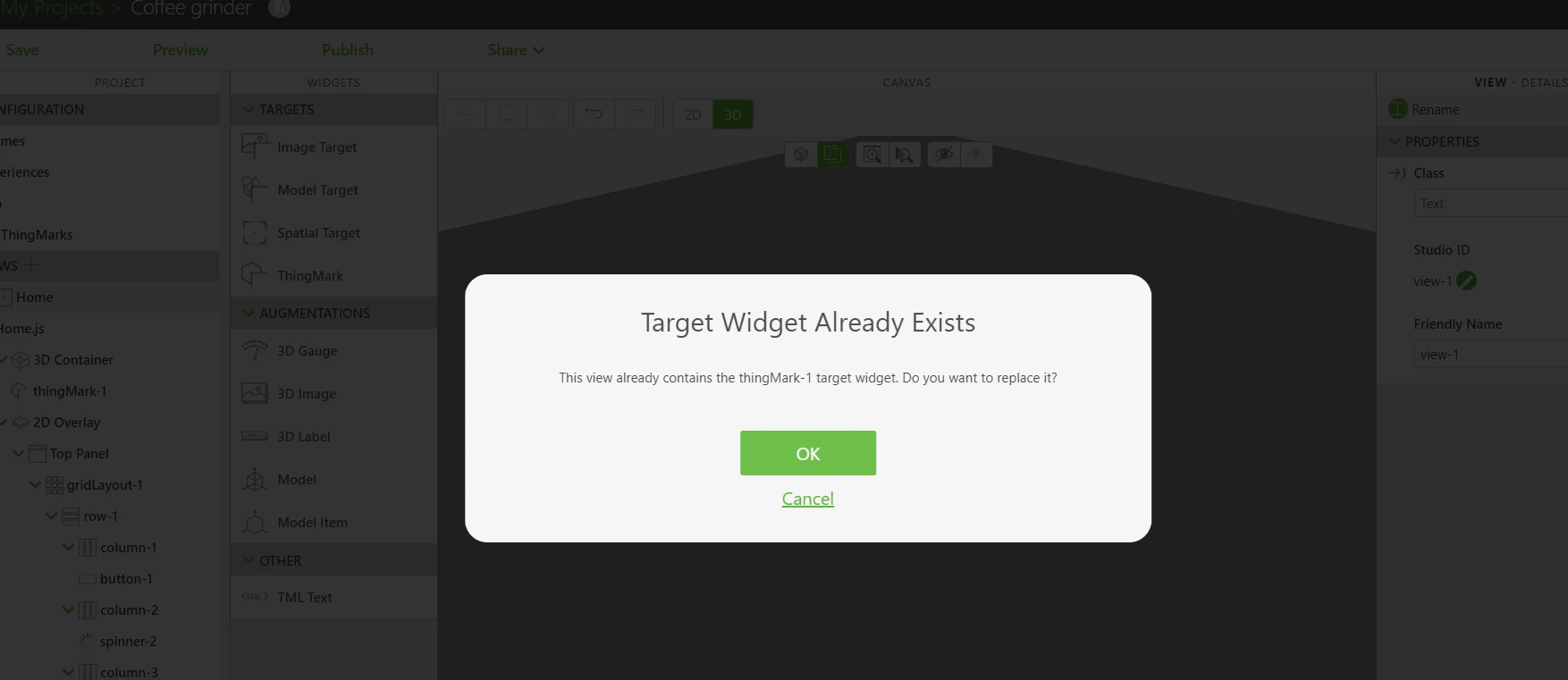

when i want use the both target this is what the error comes out
Jun 27, 2019 11:31 AM UTC
Only one target is permitted in a view. Could you explain the need to have a ThingMark and a Spatial target for your use case?
