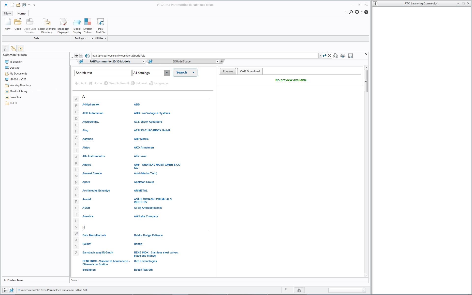

When I start the learning connector, nothing comes up except the empty window frame for learning connector.

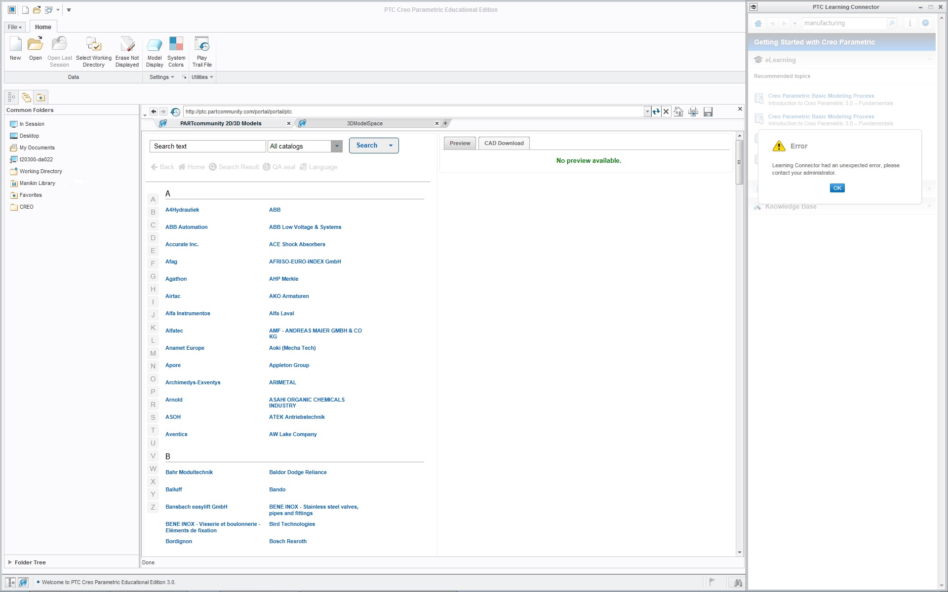

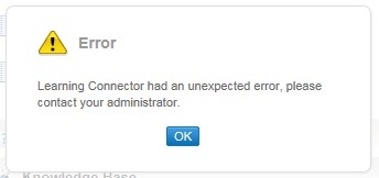

Thanks for the reply. The solution worked to some extent. Now it starts, but if I try to search topics, it gives an error message.
