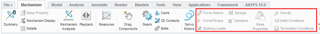

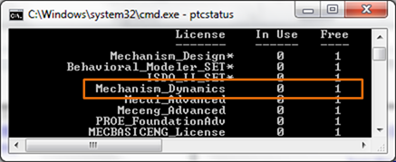

Maxime,
Creo comes with 'mechanism design' which permits study of kinematics. This allows servos, gears, cams. No forces.
When you want forces - springs, dampers, friction, gravity, inertia etc then you need Mechanism Dynamics Option (MDO); this is an additional license. Without this license springs, dampers etc are greyed out as follows
Do you have an MDO license?

Jun 7, 2017 10:16 AM UTC
Hello Charles,
Thanks for your reply
As I start Creo I have a start config, and I can choose which one I want to start.
I see for instance >>> Creo Flexible Engineering (Surface,DynMechanism,Behavior)
On the other side, I don't see any greyed icon as you displayed.
